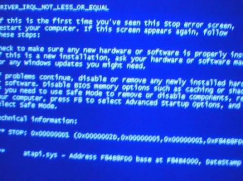

*edit* oh here it the blue screen that I got a few months ago, when I was having this same problem. I'm not sure if its the same as I'm getting now, because its just a flash and now a death screen.
someone was saying something about checking error logs, but I got rebooted before I could ask how to do that....

That error message implies that it is having trouble reading the CD-Rom drive. Can you give me a better shot of the actual screen so I can get the entire message?

hmm well that is one from a few months ago... when my cpu fan was dieing, but it been fixed since then.
how do you go into the error log?
mmm but cd rom might make since, when the case heats up, most of the heat is located near the cd drives... but i really don't know anything...

I just need a clearer picture of that bluescreen, or you can email me the dump file. If you're using Windows XP it should be enabled to dump it to a file, check your c:\windows\minidump directory.
I don't have the utilities at home to examine it though, so just send it to my work address: seand@mitre.org

Thats a IRQ conflict. 2 hardware are trying to use the same IRQ (interrupt request line).
Try to look for it, that is a really rare problem and therefore it would
be hard for me to pin it down without being physically there to look at it.
Either try to look for what hardware is using the same IRQ or just unplug
any device that you arent using.
Could be because of a HD swap or something like that too. Any change
in hardware that previously was done but wasnt completed or was not
successfully completed.

I highly doubt it's an IRQ conflict. That error message generally denotes a problem with the drivers of a specific device. The first course of action I would suggest to you is updating your system to SP2 (or reinstalling it if you've already installed it). The second course of action if this does not resolve the problem is to find the latest drivers from the manufacturer for that specific CD-RW.
If you actually want to get a clean shot of the Blue screen (with a camera), simply hit F8 when the system is starting up and select the option to not reboot on error. When the blue screen happens it will simply stay there and will require a hard reset to restart the system. I believe I saw enough of it to be sure of the error message though, but it was difficult to see if it was 0x000000D1 or 0x00000001. Regardless, taking the above steps will do the system no harm and should probably resolve the issue.

i have SP2, and i've tried reinstalling. i'll try updating the drivers.

Mintsy, just reboot your system and then hit F8 as it's booting up. It will open a menu and one of those options will be to not reboot on error. Select that option and boot as normal. The error will remain if it blue screens.
PostPosted: Fri May 20, 2005 7:41 pm
ok did that. but now its just crashing to windows -.-

Look in the event log (Start -> Control Panel -> Administrative tools -> Event Viewer), and tell me if you see any timeout errors relating to Atapi.sys.
Also, locate your atapi.sys file in C:\windows\system32\drivers, right click on it and select properties. Click on the version tab and post the version listed for the file.

no errors saying that, all of them are application(ffxi?) errors. most of the notices are "wuaueng.dll (3520) SUS20ClientDataStore: The database engine stopped the instance (0)." whatever that means..
my atapi verison number is: 5.1.2600.2180

Also, in the device manager (right click My Computer, select properties, Hardware Tab, Device manager), scroll down to the IDE ATA/ATAPI controllers, find your IDE Controller, right click, select properties, driver tab, tell me who is the Driver Provider and what version.

Primary IDE Controller
Provider:VIA Technologies, Inc.
Version: 5.1.2600.120
