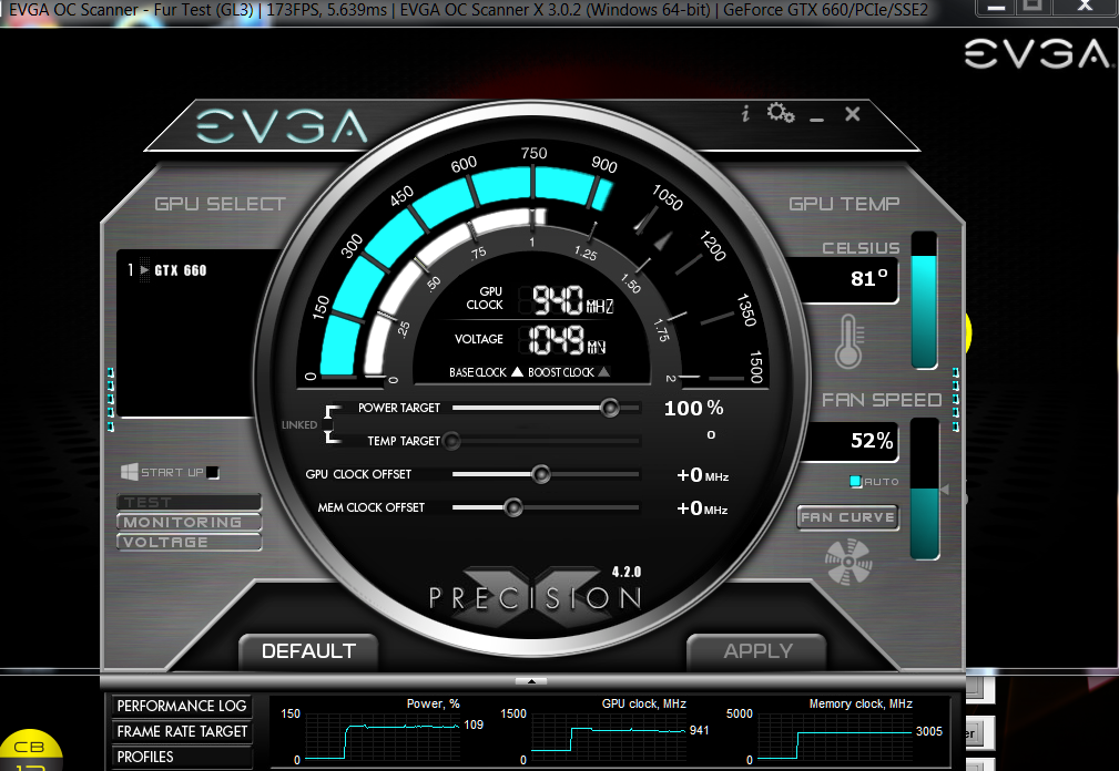

i ran a benchmark on my video card and here is the result:

81 celsius is about 180 * F, not too far from the boiling point of water

81 Celsius is ok if that's the temperature it maxes out at during a thrashing.
If it's idling at that temperature when you're just sitting at your desktop, then its a problem.
It should idle around 50 C, 110 F if it hasn't been doing anything for a while.

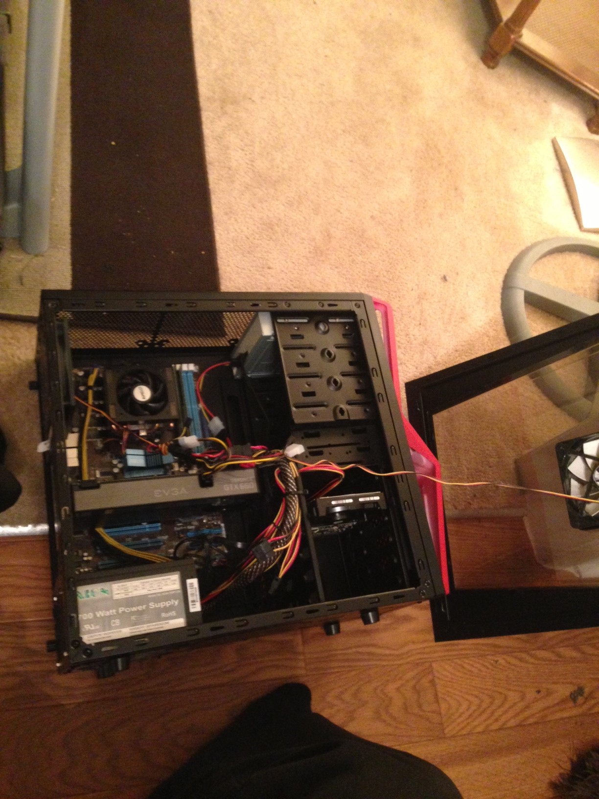

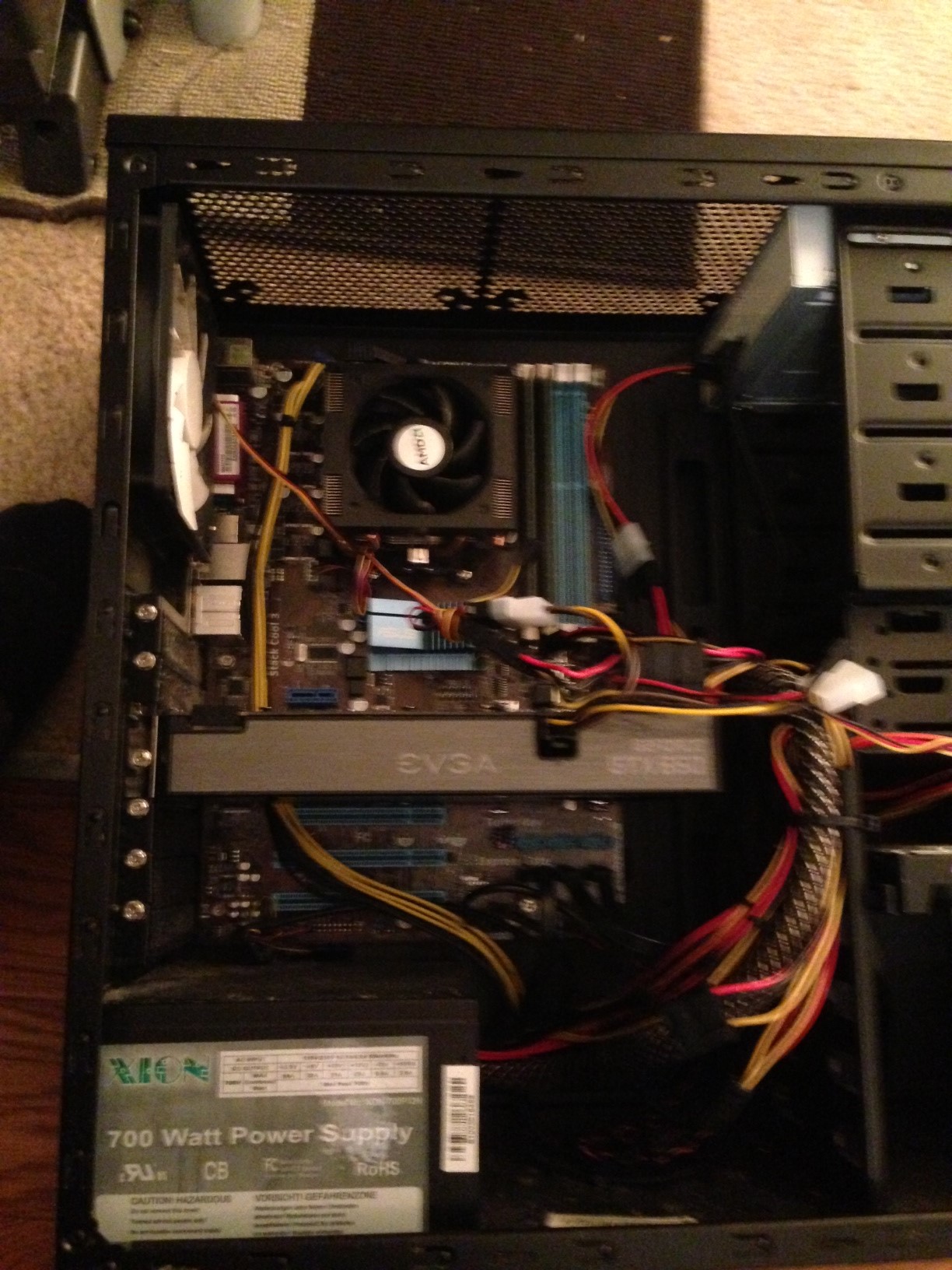

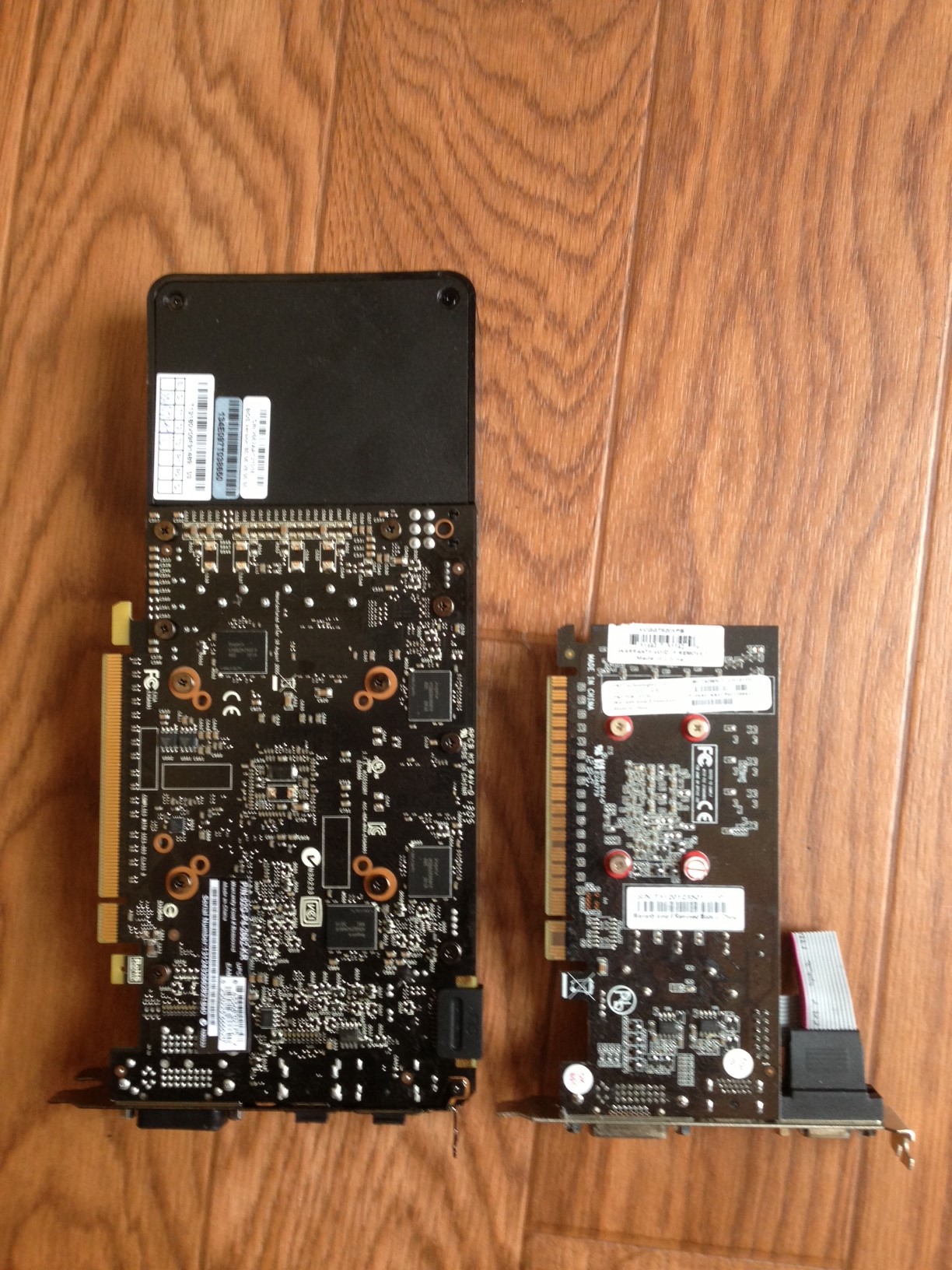

Here is my huge new video card, the Nvidia GEForce GTX 660.

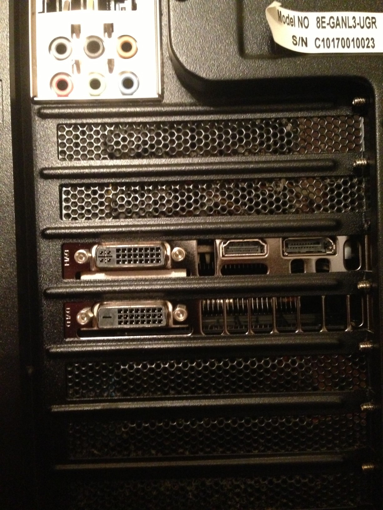

The back of my computer, with the new video card installed. I noticed that it feels upside down, but there was no other way to install it.

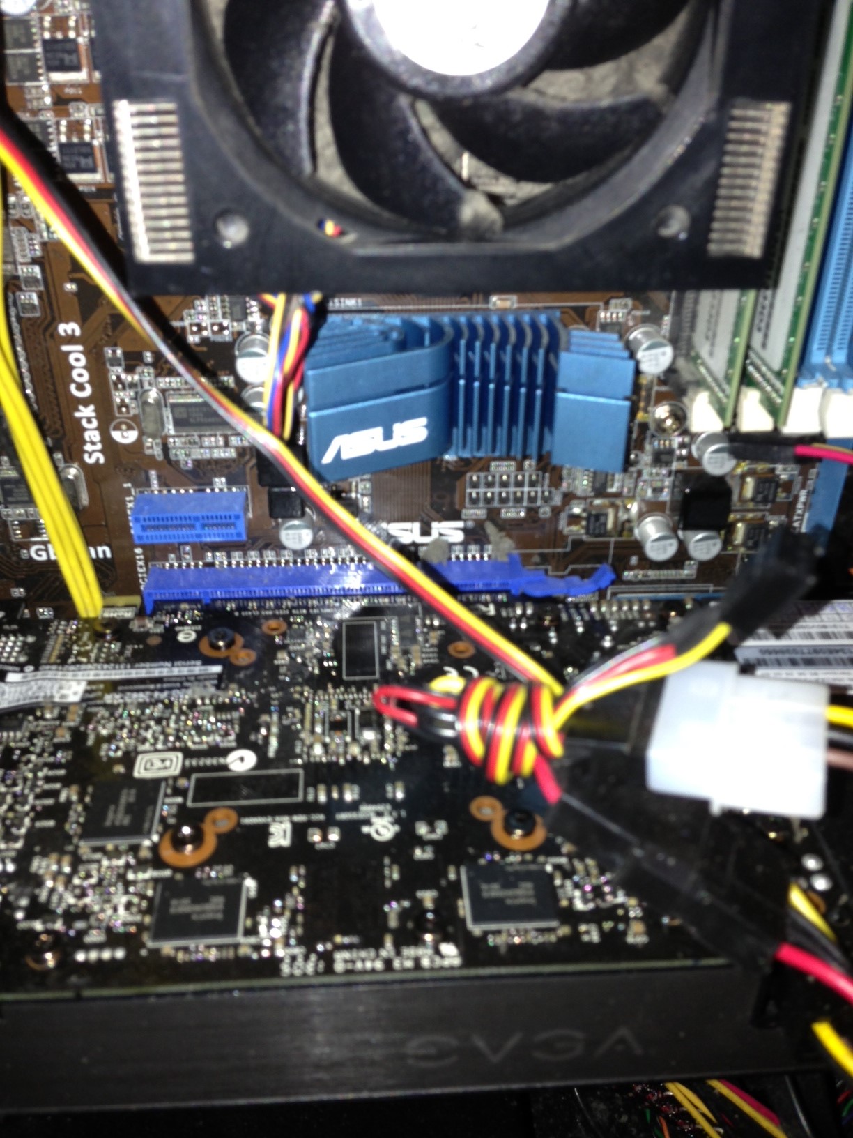

My computer from a distance, lying on its side with video card still installed (light gray thingy).
Closer up. You can see EVGA written on it.

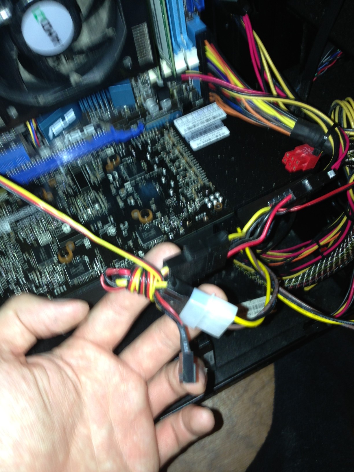

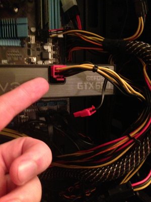

The power supply connects to the video card via a 6-pin to 4-pin adapter. It's kinda hard to make it out but the white part (adapter) attaches to the black part (4-pin, from the power supply). Then the other end of the adapter is a 6-pin. Hold on computer acting funny, gonna post and edit more. In case it crashes.

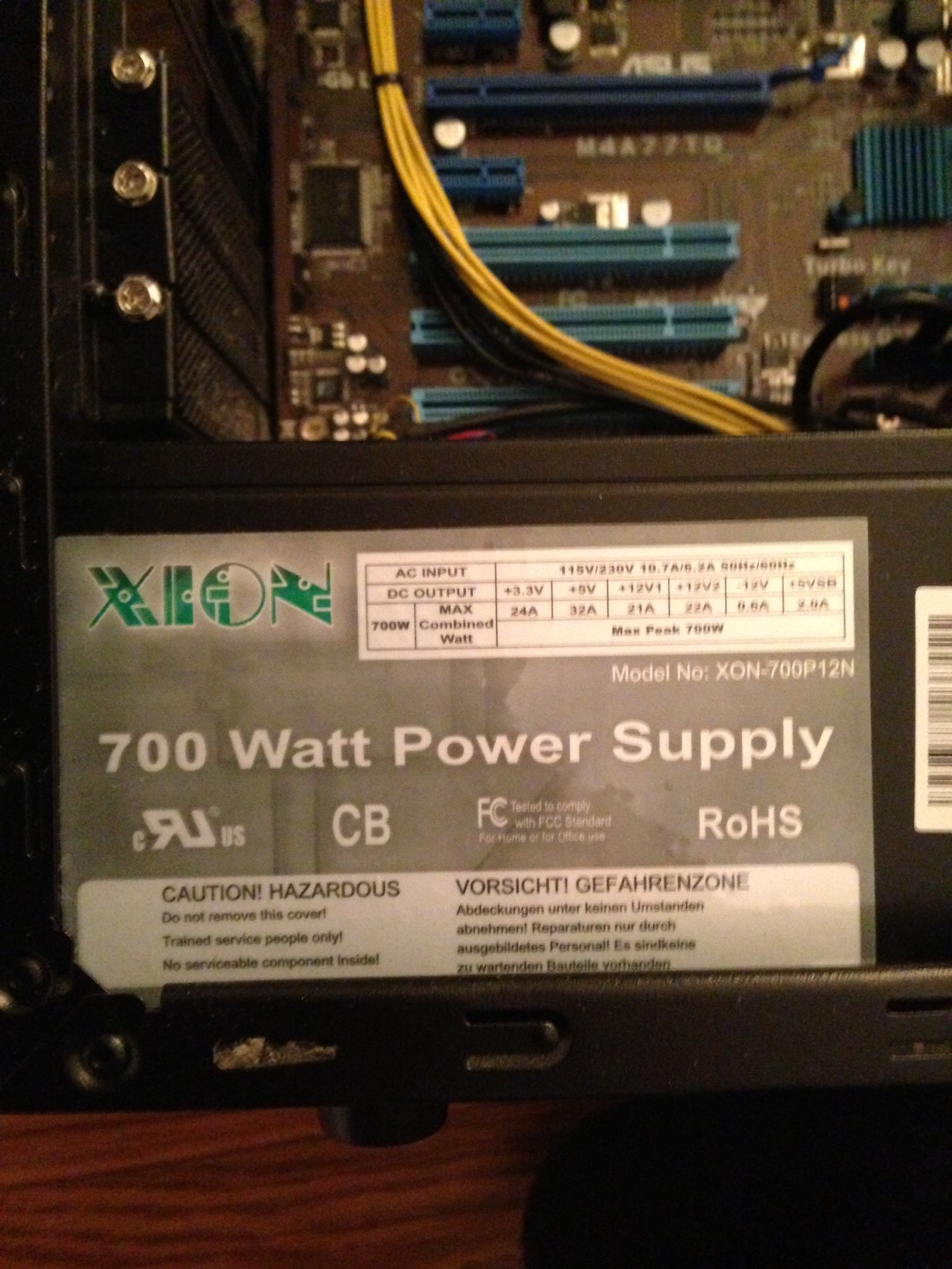

Alright so I removed my card. By the way I dusted earlier, so that wasn't what caused the malfunction. I see only the one strip for placing a video card.
Here is my power supply 700W

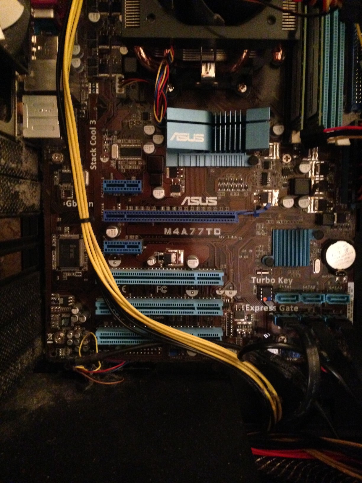

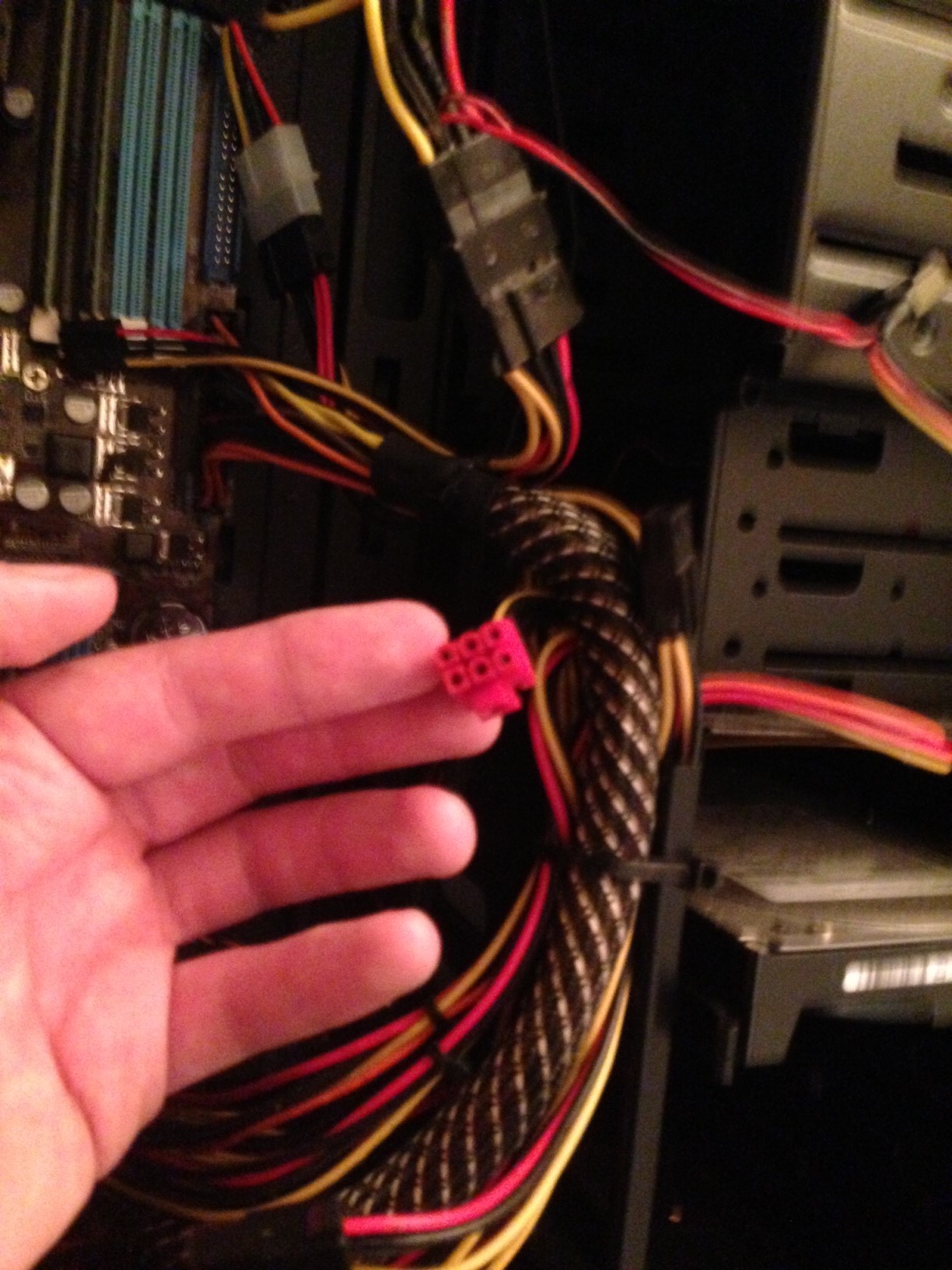

I found this little guy tucked away behind some cables. Maybe I can just plug it directly into my video card?
It took some tugging. That's what she said. But I got it to fit.

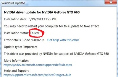

So I rebooted, I also uninstalled the driver software and reinstalled it. Yet I've been getting this update symbol every time I reboot.
Windows Update is panicking over my video card. Error Code 800F020B and 80070103
Do you think it's okay to just ignore this error?
 Post subject: Re: Video card, help!
PostPosted: Wed Jun 19, 2013 11:45 pm
I was able to play Skyrim for 20 minutes at medium graphics settings. So i cranked it up to high (the suggested settings according to Steam) and the computer crashed within 10 seconds. Now it wont turn back on. I think I killed it.
PostPosted: Thu Jun 20, 2013 3:38 am
Expansion cards are always upside down (since they moved away from ISA/AGP 10-15 years ago, anyway). Don't worry about that.
The cable on the fan on the back of the case bothers me. It won't hurt it at all, but I think I can see it has one of the small fan headers on the cable too, in which case it'd be better to connect it to one of the motherboard's fan headers. That'll allow the motherboard to regulate the fan. Don't worry about this for now though, it has nothing to do with your problem.
Is the CPU's fan cable stuck under/on the motherboard chipset heat sink? If so, move it if you can. Those heat sinks can get pretty hot.
The red 6-pin PCI-e connector was fine to use. Those plugs have shaped pins, and will not fit at all if they're the wrong connector. If it fit, it was right. That said, check what else is connected to the same rail. Like, what other things are connected to the same cable as that plug, if anything. It's recommended that your graphics cards have a dedicated rail (don't share it with a CD drive or a HDD or something) because of the massive power draw. Also, try not to share the rail that fan is using either, they cause unstable rails due to the spinning of the motor.

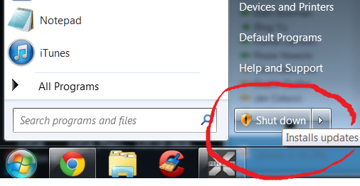

The reason for the Windows Update thing is that it downloaded the Windows Update before you installed your own driver, and now the windows update version of the driver will fail to install because it's not as new as the one installed. To fix that, go into Windows Update, find the update it's trying to install and tell it you don't want that update anymore (I believe they call this "Hide Update" these days, from right clicking the update in the list.)
Is that long yellow cable your auxiliary P4 cable? You really ought to route that cable somewhere other than under your graphics card. It doesn't look long enough to go over the top, mind. It probably doesn't hurt it, but it's a pretty important cable (it powers your CPU).
As for the computer being dead:
Firstly, you said it "crashed". Did you get an error? A blue screen? Did the graphics garble? Did it freeze? Or did the computer simply immediately turn off with no prior warning or odd thing happening? This is pretty important when figuring out what happened.
You said it wouldn't turn on. Do you mean pressing the button does nothing? Or pressing the button makes it come on and then immediately turn off again? Or perhaps it simply won't POST (the nice little "everything's working" beep when you turn computers on) now?
Will it turn on now?
If it does. It probably cut off due to overheating. And wouldn't come back on until the temperature dropped.
If it won't come on, cut the mains supply to it (switch on back of case, or pull the plug), wait a few seconds, put it back in/on. Will it turn on now? If it does, it was definitely a safety cut out, meaning it was most likely a short or unstable power supply.
Another possibility: The PSU is 700W but that doesn't mean it's a "good" 700W. Power supplies come in all sorts of varieties and it's possible to have one with a high wattage, but with crappy amps on each rail. Although there are enough watts, when something tries to draw too much power it'll overload the rail, causing the voltages to drop which is enough to make everything mess up. Usually those power supplies are cheap, so you can tell just from how much the power supply cost. I find it odd because your old (good) graphics card worked fine and likely had a similar power drain though.
As a final measure. It is of course possible that the graphics card is defective. If you had another PC around I would recommend you try it in that. But if not, you can try putting your old card back in and see if everything is fine again.
As I explained before, I did this and discovered that everything wasn't fine all of a sudden. These are very different cards though, and if it's a power draw or temperature problem, the old card probably wouldn't trigger it.
If the card is defective, can you get it replaced? Here in the UK we have a lot of consumer protection laws preventing companies screwing you over for defective gear. In general, stores here have to replace your stuff on the spot, they can't just make you go chase it up with the manufacturer yourself (though some will try, its your job to know the law and tell them no, replace my item).
I feel bad that you're having some bad luck here though.
